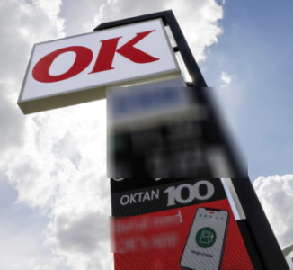

Over here the marina diesel is specified as Off Road Diesel.
Standards and taxes admittedly differ, but they state
"Off Road Diesel is uncoloured diesel fuel without the addition of biodiesel. This type of diesel must not be used as [road] transport diesel."
The petrol is 100 octane RON with 5% veggie juice.🥕🥒
The petrol is available also from many stations and preferred by many performance car owners
