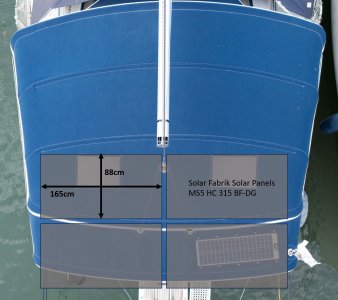

🤔 ... are you sure of the dimensions? They look more like 1722 x 1134 mm which is a standard size for a panel of that wattage .... I've been scouring the web for panels capable of charging a 48v system so was looking for high-voltage panels so I didn't have to put them all in series and I don't have space for panels that big :confused: .... also trying to avoid the backstay which is very poorly positioned on my boat.
Ended up with 4 x 315 W panels which will hopefully fit on the new arch like this ...

Yes, it was a typo!
With a bit of imagination you can fit much more solar on a boat than you might initially think.
Our previous boat had neither solar nor a bikini, so I built a bimini from rigid panels. Add a couple more wing panels and two more on the foredeck, and we had 1200w on a 39ft centre cockpit. These were 2015 era panels so today's panels would fit more power in to the same space.
On the new boat we already have a bimini so I've gone for a more conventional route, and will have 1350w on the arch with no additional panels cluttering the place up.
