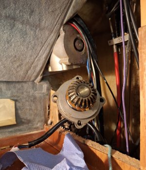

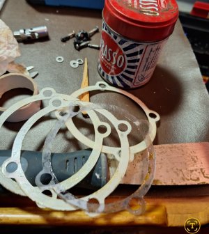

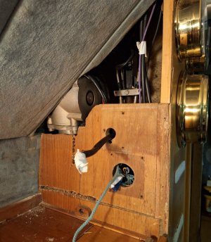

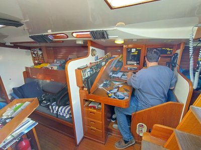

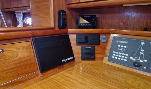

Turned the heating on and spent 6 hours stripping, cleaning and adjusting the shims on one of my steering bevel gearboxes. 90% of the job was getting access removing electrics and cutting away wood. Whilst I like having two helm stations and integrated autopilot, I do appreciate the simplicity of a tiller and windvane. Generally the boat has reasonable access to systems and fittings but not this one and it has needed the free play taken out for the last 5 years. Big tick on the to-do list. The next day was spent doing the engine and heat exchanger service. Both jobs benefitted from having plenty of time and some warmth for comfort.
Screenshot_20250108_154913_Gallery.jpgScreenshot_20250108_154933_Gallery.jpgScreenshot_20250108_154927_Gallery.jpg

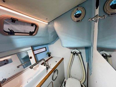

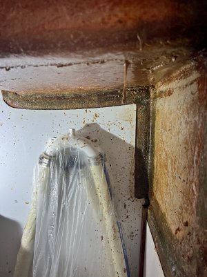

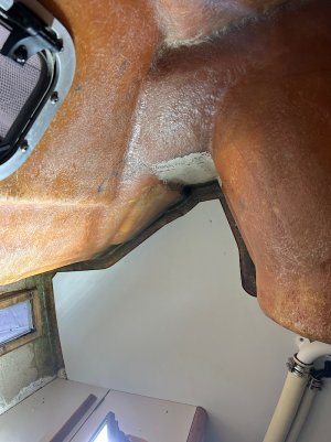

Finished replacing the headlining in the heads after the previous owners replacement fell apart due to plasticiser migration turned the glue back to a gooey mess that took a month of weekends to clean back to a good surface.
I used double sided sticky back foam from hawk house underneath the vinyl which worked better than you might think over convoluted surfaces. We made a simple Formica covered panel for the lower part and did a bit of work to the cabinet. Since the final photo, a little more trim has been added and some wrinkles worked out. I had hoped it was a job I started at the beginning of October and hoped to complete by November(working every weekend) but in the end it took me until New Year’s Eve.
