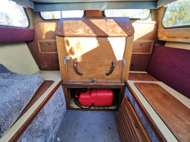

Hello again all. I pop up here every few months with a boating question related to a cheap boat I bought - my first. I have a thread relating to the ongoing project which I can update soon but I had a safety-related question and whilst I have read the numerous petrol tank-related posts on here I felt I needed a more definitive answer on this matter.
I have a 4 stroke outboard Yamaha 9.9 out the back.
The Yamaha petrol tank is inboard. within the boat itself in what 'appears' to be a purpose-built area, however, I have questions. This is the tank accessed by removing a slatted wooden panel (you can see it below on the right-hand side once removed) and I presume the idea is to remove the tank, fill it outside and return it.
Fair enough, but this doesn't seem right for several reasons. Firstly there's no hole currently for the petrol pipe to the motor to actually go once it leaves the tank, so the removable door covering the tank area would need to be left open and the pipe fed to the engine by removing the large wooden panel above it which in turn leads to the rear of the Yamaha. Secondly there appears to be no venting whatsoever in the area in which the tank sits, so again it seems entirely unsuitable as any spillage or fumes will simply get into the cabin at floor level.
I'd like a safe boat - is the area in which the tank has been placed really designed for fuel? Should I be thinking of placing a platform on the back, not unlike a swim platform, on which the 25l tank sits externally? Where did the boat builders intend for the tank to sit?
Thoughts on changing this setup most welcome.

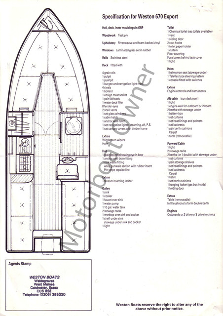

The gas is stored in a locker on the port side in something akin to a clothes cupboard. It can be seen on the above diagram half way up the boat. It is therefore quite close to the oven a little further back.
Thanks to those chipping in - it is helpful. I think the question is turning into 'where would you put a petrol tank' rather than 'where should the petrol tank be'...

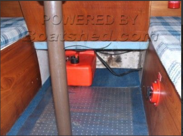

A little more research reveals that a great many Weston owners seem to have their tanks in this area, as the below images from a 'boats for sale' website reveals. I am not comfortable following this path so will likely look into adapting a swim platform or similar on the starboard rear of the boat.

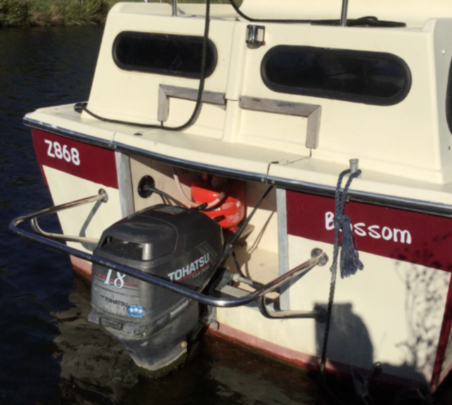

I like this advice Snowbird - it is just what I was assuming as I guessed all the other Weston's had passed their BSS tests with the tank there. Thank you. I don't wish to keep it in the cabin. A question to anyone who might know - would there be any issues with the BSS if:
I placed the petrol tank in a cage/platform roughly where the word 'blossom' is on this example image (not my boat)?
This would mean the tank was subject to direct sunlight, so I assume I would need to cover it somewhat with a plastic housing?
I'd have to be careful with placement as I may be trying to lug a 25kg full tank whilst leaning over the water at times, but that's my problem.
Having it in that position raises the possibility of impacts which would not have been an issue inside the cabin - is that a problem as far as BSS goes? The cage would/should offer some protection.
It would also be 'over the water' - is that a BSS issue as far as the environment goes? I would not refill it in situ.
Finally I would have to secure it in a manner which would be easily removed for those occasions when I fill the tank as I would/could not do that over the water itself. Some metal straps or similar which would also provide some security when moored up.
