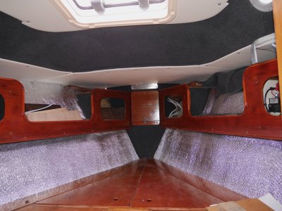

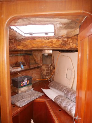

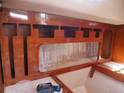

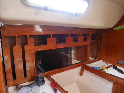

What model Westerly? Mine is a Sealord, head liner is foam backed vinyl glued to plywood panels, cabin sides were foam backed vinyl simply glued to the hull.
Had all but the fore cabin professionally done 25 years ago. I have long since forgotten the price
Since then I have increased the insulation by gluing 4mm EVA foam directly to the deckhead and then replacing the ply/vinyl panels. The EVA foam is cheap, just buy camping mats and trim to size.
Inside the lockers I have replaced the vinyl with 6mm EVA with the 'silver' face.
The fore cabin aka the 'Black Hole of Calcutta but Colder and Wetter'?
I had an upholsterer in NZ do most of that ten years ago. He did the ply panels but was disinclined to do the coachroof sides and aft bulkhead with vinyl and suggested 'carpet'. Was remarkably successful - no condensation at all even under extreme conditions.
Once again I did the locker insides and a few other bits with the 6mm silver backed EVA.
