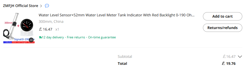

I fitted this to a friends water tank that had a VDO sender. The original sender and gauge were changed. The 2 wires from the old sender were used to send the resistance reading to the new guage and an additional neg lead was reqired on the new guage. The mounting hole and screw holes match exactly to the old VDO sender. 1719835617053.png
