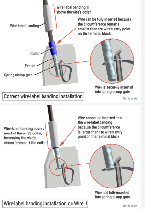

Careful with that. Moisture is not the only reason for boxes, as your house wiring demonstrates. Wago 221 fittings do NOT meet the pull out load requirements of ABYC or USCG. Even wire nuts have better pull-out strength (tested). They are quite weak at the low end of sizing (instruments). Secure the wire. You also want to make certain when you skip boxes that there is no way for anything to fall against the wiring. In other words, the location must be in important ways equivalent to a box. Not the same as a crimped and heat shrinked splice. You may know this, but I fear some may not.

Yes (ABTC complaint) and at the same time no. It is not a simple yes/no thing. They are compliant if used in a box or similar situation with strain relief (pressure connections) because the pull-out requirement is lower. They are not compliant as in-line splices (crimp connections). Read the standards below.
They do not meet the pull-out requirements for crimps or terminal blocks. They are compliant in boxes because there is a special carve out for that use (pressure connections).
I like them and use them. But they have limitations. I'm just stating this for new DIYs that may not be aware of these limitations.

And this is just one failure mode. You have to strip the wire properly and insert properly. If ferrules are used that must be done properly. They look so fast and easy, perfect for DIY, but take the time to do them perfectly. Failures are not that rare when work is rushed.
