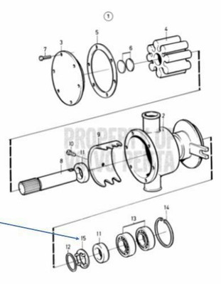

Hm - wanted to order a new water pump for my AQ225E and according to the original Volvo part no., it should be this one:
http://www.iboats.com/Circulating-Water-Pump-Sierra/dm/view_id.171891
However, when taking a look at my current (leaky) one, it doesn't look like the original one from the picture above but rather like this:
http://s30.postimg.org/b2f2by0hd/2014_09_28_15_11_15.jpg
It kind of looks like it has been changed to a different one? A link to this one on the picture would be appreciated.
It seems I was in error.
It would have been the correct pump if your leak was coming from behind the pulley (circulation pump, 4 bolts at top of your picture) but it looks like it is coming from the Salt water pump (6 screws at bottom of your picture).
This is a repairable item and will most likely require bearing replacement as well. (if the leak was form the circulation pump it would be coolant as your engine has closed circuit cooling).
Best option is to get new pump if you cant source the bearings and do the work yourself. http://www.keypart.com/stock/857451
HI 2 Seals are about ten pounds and its an hours labour at the most to repair it, unless the shaft is scored then you will need a full overhaul kit about a hundred quid and 2 hours labour, dont worry!
