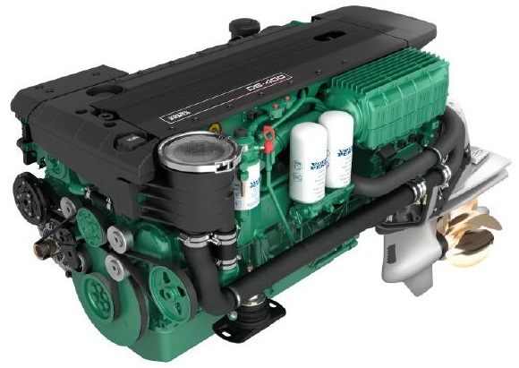

Strainer lid: See the clear plastic circular thing, bottom right hand corner?
It's the sea water strainer/filter. The original design was not great.
Improved lid kit:
This one with the four screw down thingies is actually waterproof, and works properly.
[2068]
19 Sep 2002
18,113
Coolers = Charge Air Cooler (upper right hand side, thing with fins) and the heat exchanger, which you can't really see, it's on the same side, but a bit buried behind the two white oil filter / oil bypass canisters.
If the coolant temperature at full throttle is stable at 85'C then you are in a good place, no cleaning needed (yet).

All is much clearer now. Thanks FlowerPower and Thanks for taking the time with all the pics.

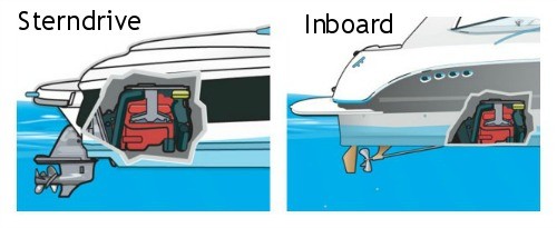

Sterndrive (outdrive)
More sophisticated. Entire drive pivots to steer. Can be trimmed to get the running angle just right, can be tilted for use in shallow water. Better fuel consumption and performance. Needs more love & TLC - more to go wrong. Typically found on small to 45ft boats.
Shaft Drive (inboard)
Simpler. Steers with rudders. Can't tilt in shallow water. Worse fuel consumption and performance, but less to go wrong. Typically used on larger boats (although sometimes found on smaller ones too).

Top replies from Top folks. So easy to understand with the pictures. Thank you.
