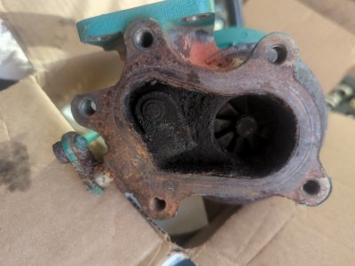

Just a "me too" reply to a common problem. This is my second time around. First time I was able free up and clean in-situ. This time I removed the turbo assembly and brought it home. To drop the exhaust side in the ultrasonic cleaner. Still trying to free up the stiff waste gate again.
