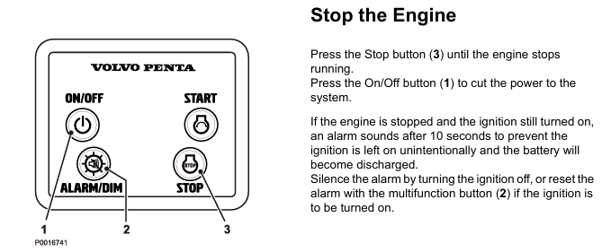

If it is an early engine with the older type of panel ITYWF the audible alarm does not sound if the engine is not running but if it is a later engine with the modern type of panel it is an intentional alarm to remind you to turn off the panel.
The owners manual says
