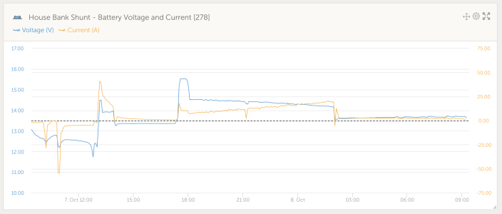

This happened last night:
The interrupted equalisation is clearly seen at 18.00 last night. Then steadily the V decreased (temp compensation?) and the A increased until 02.00, charging 20A at peak. Then in to float since 02.00. Battery temp increased up to 39C at 02.00 then reduced. It seems that I’ve been misled by the Multi going to Storage mode having not fully charged the batteries. The equalisation seems to have kicked off a Multi realisation that the batteries aren’t fully charged. Not great is it.

look, it's pumping lots of amps for 8h! definitely batteries not full.
