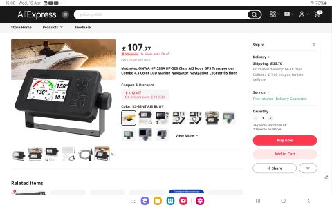

Onwa seems established as a good cheap brand backed up by official UK dealership.
I've just found this on aliexpress, dual channel ais tranciever, B+ and a whole £25 (plus £35 postage) :oops: . Could buy nearly 40 of them for the price of a older tech raymarine..

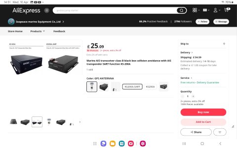

I recently sold one of these units. It was really nice, superfast at gps location, could use it to plot a course.. would buy another if i needed another ais unit
I think that's the price for the antenna - AliExpress has a habit of showing a picture of something expensive, then choosing only a component and the price for that.
25 quid is only for the antenna .... click on the AIS unit and you will see real price !!
