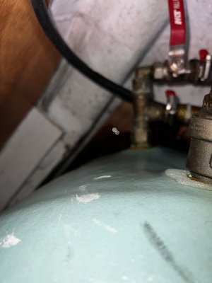

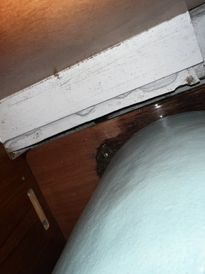

IMG_1048.jpegPipes / valves are dry but there is water on the ledge the water heater is dirty so it does seem to indicate it is that my water is pressurised, and I’ve not heard the pump go other than running taps clearly there is water there though and it’s not salt water sre the tanks themselves prone to leaking?IMG_1047.jpeg

View attachment 178948Pipes / valves are dry but there is water on the ledge the water heater is dirty so it does seem to indicate it is that my water is pressurised, and I’ve not heard the pump go other than running taps clearly there is water there though and it’s not salt water sre the tanks themselves prone to leaking?View attachment 178947

There is no label. So haven’t a clue. Just spent 20 mins watching for drips. None seen. It’s a good 4 inches above the hull so is going to be the source.
Perhaps the tank is cracked.
I’m at the boat for another 2 hours. I’m planning closing both fresh water tanks valves and then using the drain valve on the heater tank to empty the system before I go.
Feels extravagant to buy a new tank without knowing it is busted for sure. But short of removing it and stripping the insulation I won’t know? The insulation is on the bottom too?

Neither the engine nor the mains heater has been on this weekend, and the water has collected. Given it is on the wood the heater is mounted to, and the drain / pressure release valve goes under the base and into the sump, I don’t believe it is the release valve. It is probably half a litre that has come out. It’s collected in the the part where the forward keel bolt is. That’s also rusted more than I would like since the survey sited some mild surface rust.

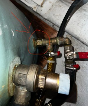

Identified!
It’s this connection. Well at least this connection is leaking a little. Guess I just give it a tighten… really hope this thread helps someone else in future as finding this wasn’t fun.
