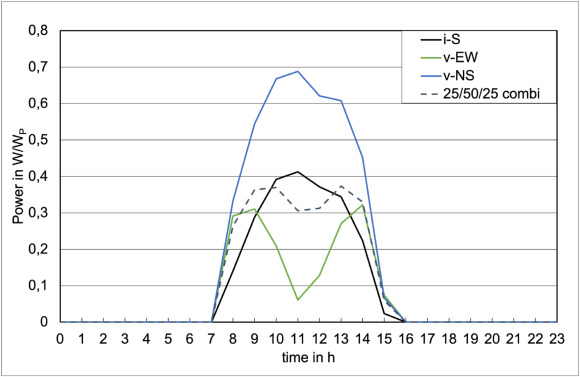

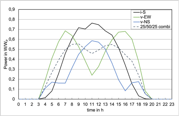

Two interesting graphs. The output of solar systems summer and winter, in Germany. The project related to large grid farms on agricultural land. Note that shading from adjacent rows of panels was not included, which seems odd.
Two interesting take-aways:
  • A mix of vertical and inclined panels smooths power production through the day. Important for grid systems, not so much for sailors.
  • Vertical is better in the north (very few US sailors are this far north but many UK sailors are) and in the winter (few of us cruise in the north in the winter). Inclined is better in the south and in the summer.
I think the point is that the best orientation depends on the project, and that both vertical and inclined are the right answer sometimes. Clearly, now that we have bifacial panels for not much more, we will be seeing a lot more vertical farms. Perhaps not on boats, but on agricultural land the improvement is obvious. And there are other advantages (construction and maintenance). Snow coverage is a big factor in some areas; inclined panels must be steep enough for it to slide off and flat can fail for long periods.
Cool. Thanks to the OP.
Summer
Winter
