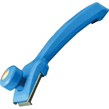

So this time, I used a SHARP draw scraper (similar to this http://ecx.images-amazon.com/images/I/41n7a5RMoJL._SY355_.jpg) and some cabinet scrapers. I found it essential to keep the scrapers sharp, using a diamond hone quite frequently. I also took the corners of the draw-scraper's blade, to avoid the blade digging in. I used an ordinary (sharp!) shave-hook to get into difficult corners.
USed carefully, this gave excellent results, and it didn't take too long. It also left a surface suitable for immediate varnishing (the final scraping used the cabinet scrapers). I didn't find it necessary to use either hot air or paint-stripper; I am pretty sure that neither would actually have made much difference to the time taken or the quality of the result.

I used a SHARP draw scraper (similar to this)
Fixed image, links below...
http://www.amazon.co.uk/exec/obidos/ASIN/B001C7QLEE/dolcetto-21
http://www.amazon.co.uk/exec/obidos/ASIN/B000MPQDCW/dolcetto-21
