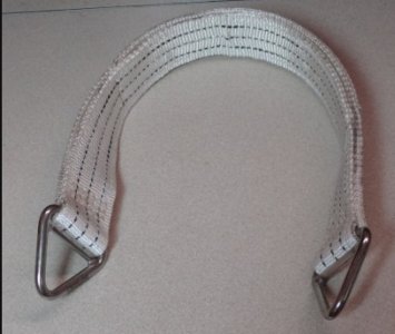

Webbing can easily be sewn even with a domestic machine, just go slowly, as an example I made this boom strap with a domestic machine, it's about 1cm thick I might possibly lift the boat with it. :)

Thanks :) Just remember if you sew several layers keeping it flat then it won't take the U-shape, sew it while keeping it curved, adding maybe a few staples here and there to keep all layers together in the final shape.
