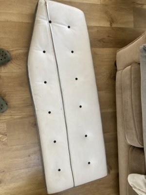

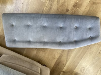

Hi all,
I have just removed all of the soft furnishings from my boat as it's winter here.
A lot of them have covers with a zip (removeable) and buttons, which prevent the covers coming off when you unzip them.
Is there tried and tested method of removing the buttons so that the cover can be removed please? They could do with washing,
The only way I can see to do it at the moment is to remove all of the buttons and then replace them all afterwards, which is going to be a pain.
Hoping someone here has a better idea.
Cheers, Nick.

The buttons will be held by a cord, so just cut the cord. Use a long upholstery needle pass the new cord through the foam to refit the buttons. It only takes about 3 to 4 minutes to refit a button, so you should allow half a day to do a complete set. This is far less in time and money than replacing your cushions. When I had new cushions made (foam and fabric), I saved a little by fitting all the buttons myself. It was certainly not very difficult to do.

an inexpensive simple tool to assist in passing the cord back through the cushion, and suitable cord, from upholstery suppliers, but you could improvise with something else.
A wooden kebab stick with a hole drilled through at the pointy end and thick whipping twine does it for me. It's easier for two people to do - 1 to squish down the foam and the other to tie the knot on the rear button.
It doesn't take me minutes to do each button - minutes to do each cushion of 6-8 buttons,
Mine are fabric, not vinyl. The difference after a wash was well worthwhile. The colour was restored and the mingingness banished.

When I recovered the cushions on Blush Hawke House covered buttons in my fabric. I specified plastic buttons so they didn't corrode. They had hooks on the back. HH provided twine loops in a couple of lengths for different thickness cushions which went from the top buttons to the under buttons.
I used a long buttoning needle to pull the loops through, connecting them to the needle with a length of thread. The cushion had to be squashed to get the back button on but it wasn't difficult. For washing the buttons could be removed without having to cut the loop.
Yes, did this with all 19 cushions on Arpeggio. Two people, some whipping twine and a carefully shaped wire coat hanger wire. 🤪

Sorry I don't have a better idea but having done this, replacing the buttons is not that difficult. There are some good videos on line.
Been there, done that and removing the buttons is the only way to do it. It's easy enough - there should be enough give in the foam to allow you to cut the cord beneath the button. Putting them back isn't a big deal; as the existing button cores had gone a bit rusty, we even replaced the buttons with new ones, covering them with material that was a close match to the original. You need a long, stout needle to replace the buttons.
