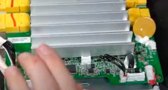

I can't say for sure but the BMS doesn't look like anything Daly make. In Will Prowse' tear down he comments he isn't sure who makes it (and he sells various BMS so would know) so it may well be proprietary. Built to handle 180 amps with multiple cell balance wires etc.
Might be worth watching his tear down to see if you recognise it..
Will Prowse pushes the Overkill BMS. This is actually a JK BMS that it's slightly modified with different external wiring. It is sold on the basis that you get excellent service back up if you need it.
