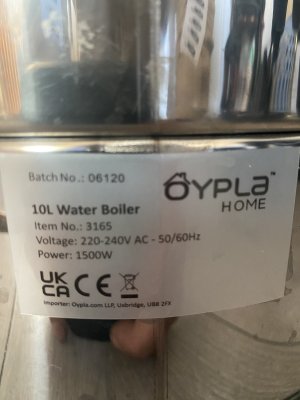

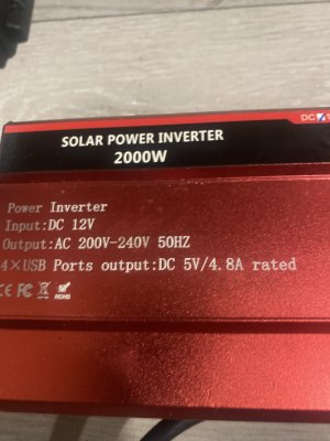

I have this converter that pulls out 2000 W
Converts 12 V to 240
But I have a problem. I’m trying to run something that is more powerful than this like a kettle. What is 220 to 240 1500w can this be done? And if so, what do I need to step up or step down the power?

I'm confused.
The water boiler in your pic is rated at 1500w, the inverter is rated at 2000w, so it should run it.
You also mention a kettle, which is usually 3000w, so the inverter will not run it. Best option for a kettle would be to get a 1000w kettle.

Op refers to a kettle, but the pic is for a 10l water heater.
I'm surprised your 3kw inverter will not cope with a 2kw kettle, what size cables do you have from the batteries to the inverter ?

Although the OPs inverter label says 2000w, is that constant load?
Our inverter is labelled 3000w but that's peak power. Constant load is only 1500w.
His inverter looks a lot like the cheap tat available on eBay etc for £30 which make ambitious power claims but are supplied with crocodile clips or even cigarette lighter adapters. If he does manage to power his urn (giant kettle) from it - he might be in for a shock how much power it will use…. I think he’d be lucky to still have any usable power in a 120A lead acid battery by the time it boils…

My 3kva Victron is rated for 6kva peak. But it's possible that cheap units are a bit less honest with the figures.
Possible = true. Not just a 'bit less' honest - complete fabrication. Run them at the claimed maximum most go bang in a very few minutes. The quoted 'peak load' is almost invariably a theoretical absolute maximum the circuitry ought to be capable of. A bit like cheap audio gear claiming a peak power out of 200 w from a 10 watt amp....
