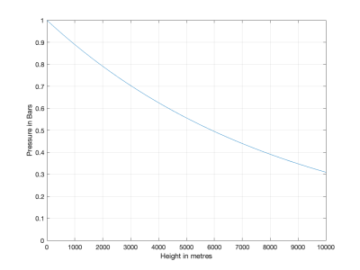

The arguments and statements about 'Carbon Dioxide is heavier than air so will move down', which also is said about propane or butane gas, are all complete boll*^£s. There's a difference between a gas and a liquid; in a gas there is no displacement, the molecules are not bonded together and all bounce around in thermal equilibrium and just mix since the distance between molecules is vast compared to the distance over which they interact, ie they just bounce off each other like billiard balls. It's what gas means!
To calculate the change with height you have to apply the Boltzmann distribution, which is that at a height x the number of molecules per volume,
n(x) = n(0) exp(-E(x)/kT)
where k is the Boltzmann constant, T the temperature in Kelvin and E(x) is the energy of a single molecule as a function of height. E = mgx, where m is the mass of the molecule, g the acceleration due to gravity (9.81ms-2 and x the height. The mass of a molecule of Nitrogen (air is 4/5 Nitrogen) is 28 / NA grammes where NA is Avogadro's number, thus 0.028 / 6x1023 kg.
Putting these into the formula (and assuming temperature doesn't vary much) one gets the reduction in the number of molecules with height as shown here:
which shows the expected reduction to 0.7 atmospheres at a height of 3000 m.
More to the point, the difference in concentrations of CO and O2 over 2 metres height will only be 3.3x10-5, or one part in 30,000. Gasses just don't collect in the bilge or rise up - they just disperse in all directions, very fast if small molecules, rather slower for very large molecules.
