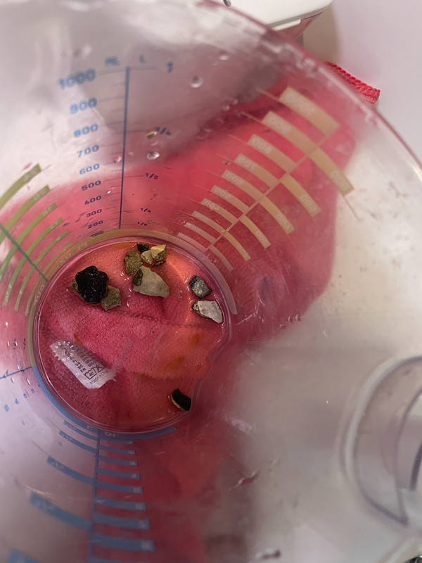

So I disconnected the hose from the back of the toilet….and these are some of the rocks that fell out

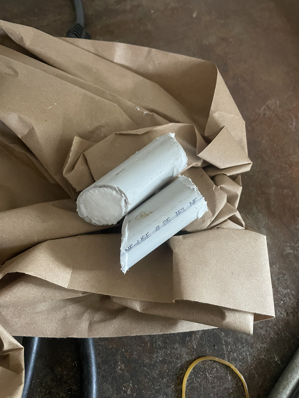

Back to the workshop to make some 25 mm bungs to seal up the hose before I entomb it forever
My theory is that this is the build up on the inner walls of the hose....which is normal for a toilet hose....but when I used an aggressive mix of strong vinegar and acid.....it dislodged it and put the stones in circulation. So it would have eventually blocked....and I’m glad I am changing it.
Remember....this is what the insides of your kidneys look like
Ok..,so I cut a couple of pieces from a 25mm pvc pipe and filled them with mastic..,hopefully by tomorrow they will be suitable bungs
