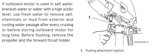

You should find a bolt under the engine which is removed to fit a flushing plug for a hosepipe.
😧 How is it possible that I've read dozens of threads on flushing small outboards, and this is the first I've heard of such a fitting on my own?
I must learn to read the manual.
D'you mean mine, or did you succumb and buy another? ;)
Wait, there's a flushing bracket for a Tohatsu 3.5 2T?
Why do you need to remove the prop? Seems needless? Just safety in case you knock it into gear?
Is the part number ENOF02040-0? I can't find it online?
Game changer.
Anyone know do the Mariner 4/5hp 2T have similar?
It's all new to me, too...if anyone knows, please chip in.
Andsarkit's video in post 10 seems to show the operation clearly, and I've found the bolt on my 3.5...
...although the stream looks pretty weak from the telltale, assuming there is the usual domestic head of pressure in the hose.
I too wondered why it would be necessary to take off the prop. :confused:
