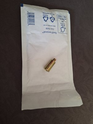

Andsarkit's video in post 10 seems to show the operation clearly, and I've found the bolt on my 3.5...
...although the stream looks pretty weak from the telltale, assuming there is the usual domestic head of pressure in the hose.

The fitting is an M8 thread and so the centre hole is quite small which restricts the flow. The fitting I have also fits the flushing port on the leg of my Yamaha 15 2T so I expect the fitting is fairly universal.
If you have a lathe you could probably drill a hole in an M8 brass bolt and cut off the head and make your own fitting.
Thanks.
I *think* it's gonna fit my Mariner 5hp 2T as well. That's a massive advantage if it does, it's a heck of a lump to lift into a wheelie bin!
