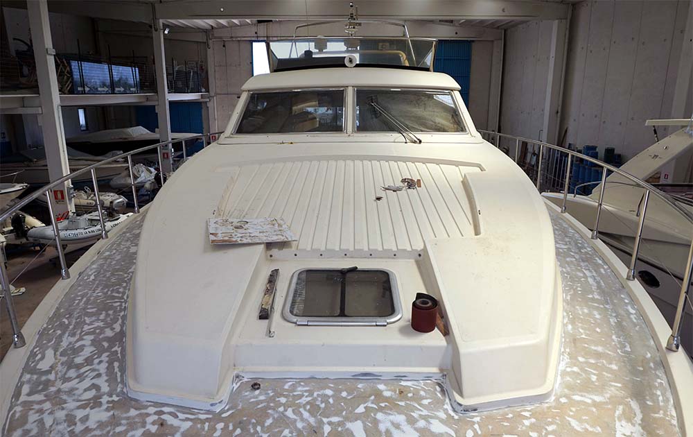

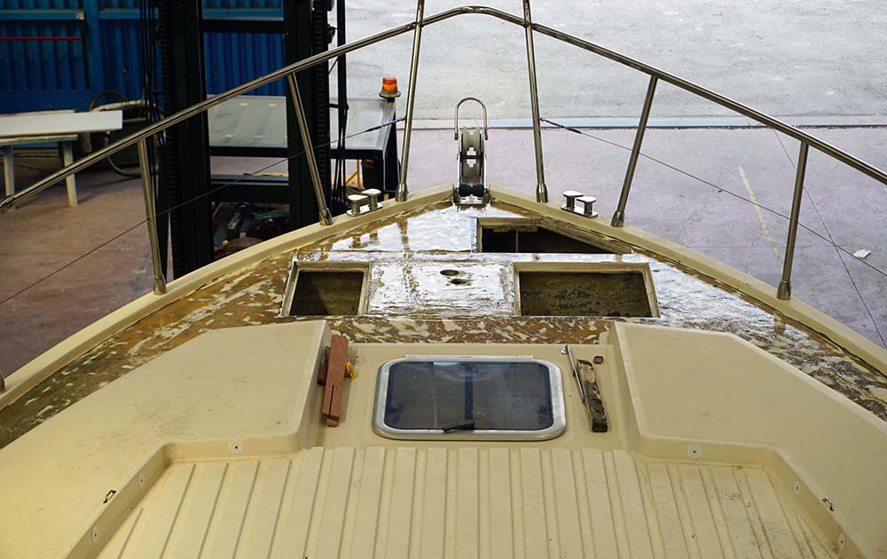

I don't think it's actually a big mistake of Princess/Watsons, M.When Princess installed the teak side decks (I believe they are made by Watsons), they build a join in the middle.
To make it look good, they "tooth" the planks so that every other one is longer that the other.
IMO, this is a mistake.
Water penetrates the gap and to make the matter worse, they screw the loose ends down.
You were rather optimistic in this respect.So, this week, we had to drill out every screw hole and fill it with Epoxy
A job that I didn't expect but needed doing.
