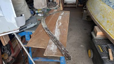

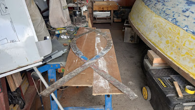

If you look at the transom the port side is its correct position and the starboard side as fallen down, due to a poorly dne replacement of the beam shelf down the starboard which was not refixed to the rest of the deck structure.
When we laid the two sets of transom cover plates they are identical in shape and length.
This shows that they were not put back on as they would have showed up the change in shape that came about when the starboard shelf repair was done.
Using these as patterns it should be able to gauge when we get the starboard side back to the correct shape when when start removing more of the starboard framework and let the hull regain the correct shape once more.

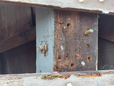

The steering turning blockwhich is bolted through the planking, originally with eight bolts, However, there are only five remaining in position. There will be eight fitted back when this block is replaced and when the hull is re-planked.
The massive steering turning block which is going to removed and replaced with a new seasoned oak block and then bolted back in position when the port side hull planking is finished.
