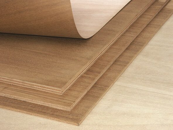

Due to EUTR Regulations, Teak cannot be imported into the UK so is currently unavailable.
Buy Teak wood online - iWood
Try
Teak Faced Plywood | Bespoke Marine Interiors | Hawke House Ltd
Teak Faced Plywood
Plywoods are not available to purchase via the website. For more details or to make an order, please contact us on 02392 588 588 or email info@hawkehouse.co.uk
Prices quoted exclude v.a.t. and are ex-works (Bristol)
1/4 Sheet1/2 SheetFull Sheet
1.8mmN/AN/A£182.22
4mm£52.89£102.79£199.57
6mm£56.33£109.67£213.34
9mm£58.33£113.66£221.32
12mm£61.25£119.50£232.99
