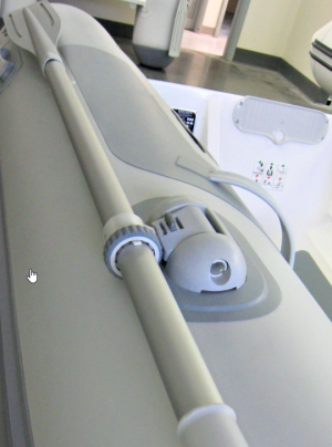

I used to have a 240 Zodiac tender that did me well but eventually perished.
Whilst the sliding collar rowlock style oar fitting used to break regularly at least I could slide the oars in/out to fit my rowing style and passengers in the dinghy - nice and easy to row.
I've since bought a 250 Talamex and the totally fixed oars now drive me mad as when rowing I'm constantly hitting passengers in the knees (the oars end up feeling too long inside the boat).
It makes the bigger Talamex feel like it's half the size with passengers as they can't get far enough away from my oars.

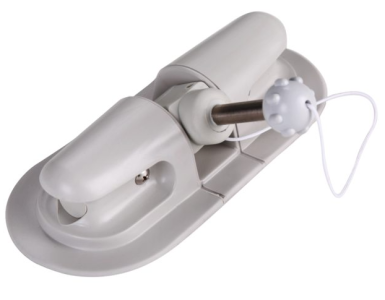

Does anyone know if you can get a sliding collar type oar that will fit the Talamex pin type fixing?
With davit pads glued on it's £1000 invested so I don't want to have to get another dinghy but would welcome better oars!
Thanks
Fixed Talamex oars
Sliding Zodiac style

View attachment 172763View attachment 172765

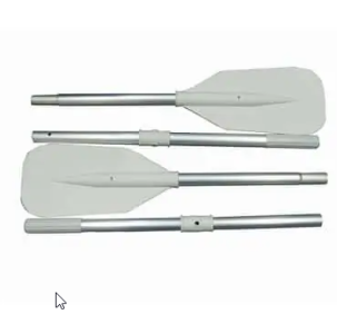

Cut the plastic handles off and slide a white 1 1/2 inch drain pipe over the ends and you have telescopic oars

Could you buy the zodiac 'system' and modify it to fit the talamex ? Both look similar design stuck on the dinghy.
Ah yes, that's a good idea.
I'll ask the RIB repair chap who fitted my davit pads about removing the existing rowlock pads and gluing on some replacement Zodiac fittings. I understand you can remove those glued on fittings from a PVC dinghy if you go carefully.

IIRC, The plastic collar that the oar attaches slots through has a rivet stopping it sliding up or down? drill that out and position it where you want and then re rivet it, drill the ally oar out to the same diameter as the original hole and bobs your uncle.
The pin fixed to the dinghy that slots through the oar takes an M10 stainless steel nut to replace the plastic dome nut.

If the issue is the inner ends being too close, why not simply take the plastic handles off, shorten the ends of the tube by a few centimetres and put handles back on. I fear extra holes at the pivot point will weaken the oars.
I had a look and actually there's more chance of getting the handles off than the collar (middle collar seems to be glued not riveted).
Your version of the idea might be more doable (y)
Only need an inch or maybe two taken off to give a bit more knee clearance.
Start with an inch and try that before removing two? :)
