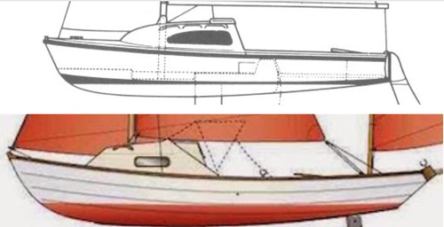

Cracking looking boats and I suspect slightly more cabin space than a Drascombe.
I don't say the Nimrod's cabin isn't marginally bigger...though it's sure to look bigger on a smaller hull.
Those proportions are about right - the Coaster is 4ft longer.
