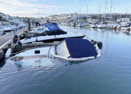

Couple of observations
Looking at the age of that boat ie. pretty newish, highly unlikely to be any deterioration in hull or its fittings ie bilge drain/bung . ???
Either nobody was keeping an eye on boats in that marina ( the staff) and spotted a very gradual alteration in trim or was it sudden catastrophic event and it went down in an hour or two between marina walkrounds.
Call only recall a removable "drain bung" being found in small speedboats and craft likely to be removed from the water, never in something of that size where any bung to work properly would be under water 90% of the time.
A 23ft Regal had the misfortune to own of about that size certainly lacked any drain plug(s) and bilge only emptied via a bilge pump.
Call only recall a removable "drain bung" being found in small speedboats and craft likely to be removed from the water, never in something of that size where any bung to work properly would be under water 100% of the time.

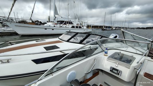

It has a bung but I don't know the circumstances on how it came out.
I put a new O ring in it. PTFE tape and sikaflex around the fitting before she was launched at Hamble point.
She's still floating!
Retrieving/ towing her up the Hamble was interesting.
It was neap tides but a strong SW blowing up.
My brother was on Zoom 3 , I passed a line so we could pull Zoom 4 off the trailer.
We then needed to rig Z4 alongside Z3 .
It was tricky!
We had a near miss with a mooring pile but managed to shorten the line in time.
Then we headed upwind to clear water where the plan was to rig for the trip.
Wind was so strong we decided to keep Z4 stern forward.
We did 3 knots and steering was remarkably good for a 17ft wide vessel.
With hindsight, a lift on a crane would have been the better option...

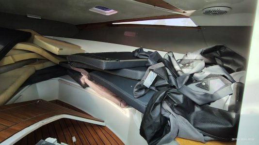

I don't even know where the batteries are!
(Because I'm focussing on damp removal first).
As a side note, the foam and cushion covers are drying nicely, dehumidifier stopped as it was full...
This is the interior on collection:-
Are you going to remove all the linings?
They look screwed in place which is handy
If its got a self draining sink, id leave the dehumidifier in continuous with a hose for a good few weeks
