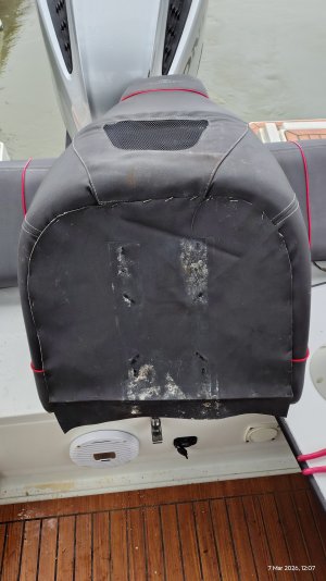

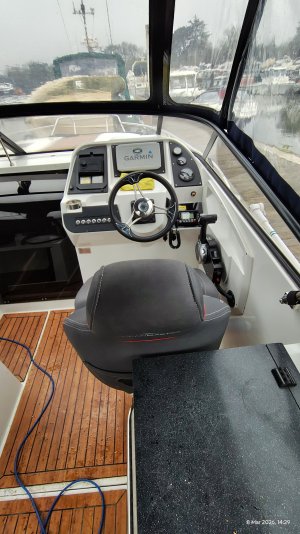

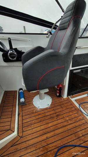

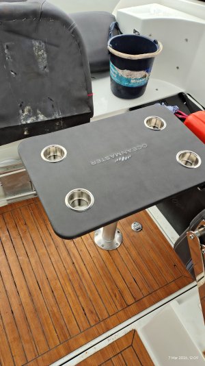

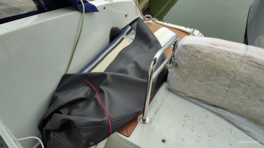

I've rescued the table and it's new as the previous owners bought a teak one.

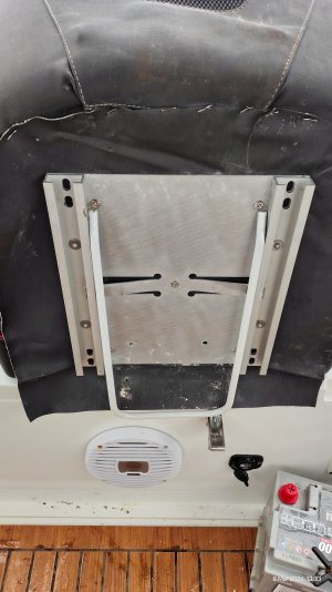

The helm seat and pedestal are ready to attach, the lift mechanism was stiff so a squit of cf50? Corrosion inhibitor worked.

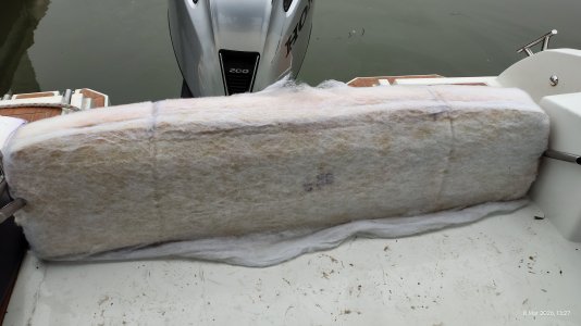

Update

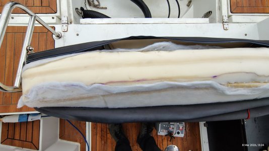

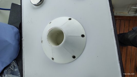

I mostly fixed the helm seat and pedestal before the driver bit shattered..
The previous owner was short and had a custom pedestal fitted. So the original one was left in the boat.

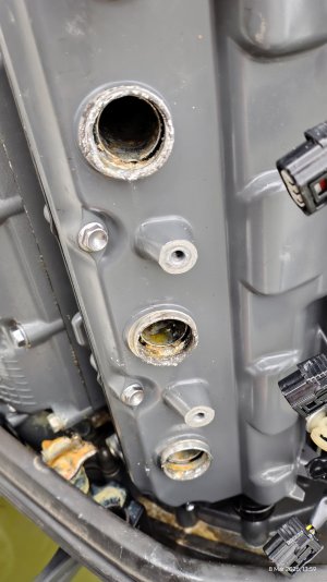

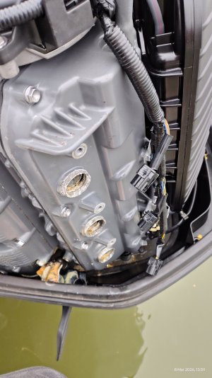

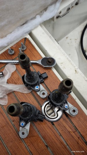

I tightened all spark plugs, refitted the ignitors and connectors.
Tried starting to no avail. But it turns over nicely.

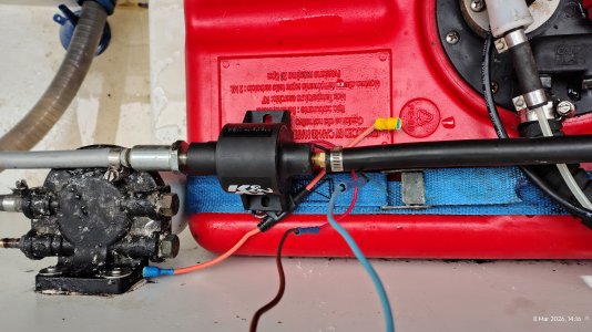

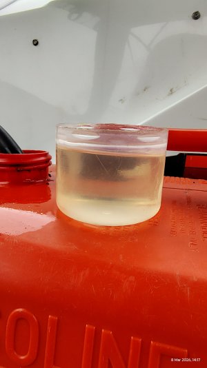

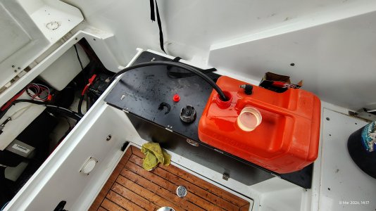

I also thought the fuel tank was full of salt water but when I pumped it into a container it's all petrol.
I'm ordering a new 110 a battery as the original ones are 5 years old and even showing 12.8 v after charging they are weak.

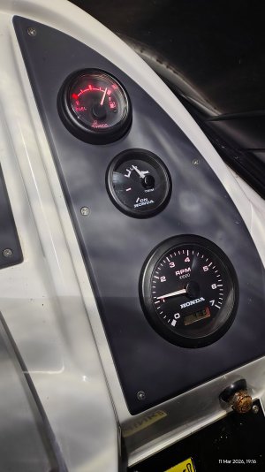

Tonight myself and a boatyard friend, installed the battery, used fresh fuel from a separate can, cleaned the plugs several times and, eventually the engine started!
There isn't any charge so we suspect the split charge relay is toast. Also the trim down switch cuts the engine. No doubt a salt water ingress problem.
Either way, she started with a big plume of smoke as all the inhibitor burnt off .

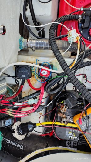

I'm chasing the fault that when I use down trim on the throttle it kills the engine.
Same issue with the engine mounted switch so I think something is shorting elsewhere.
The trim relay is a suspect so I'll do a test on that.
The Honda manual has lots of fault finding charts which is helpful.
I'm not getting a charge at the battery so I'm tracing the wires and disconnecting the split charge relay etc.
I'm minded to just rip out all the bilge electrical wiring and start again ..

just a tip from my previous " Ahem" restorations, before you rip anything out, bypass/jury rig up something first to ensure it is the wiring thats the problem. In many instances the earth or ground wiring was frequently the culprit for something not working.
Have pulled out wires willy nilly with a "surely new wiring will solve the problem quicker/faster " only to discover later
(and having ensured more work) the problem was actually a result of something unsuspected elsewhere.

Sorry, but you are just wasting time and effort messing around tracing individual faults. Many things that seem to work now will give problems sooner or later and you'll forever fixing stuff. If it's been submerged, get it changed now. New wiring and any relays etc.

Agreed,

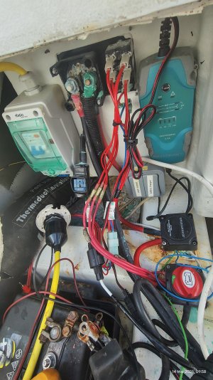

I've taken out nearly everything. It's in a shocking condition, not all caused by sinking I feel...
I'm now down to the outboard power leads directly onto the battery and the charge wire also attached to the +ve.
Starts ok but no charge alarm going off on the throttle unit ( which escaped a dunking, I checked all connectors as well).
It's likely the alternator is faulty but I'll ponder a while and study the wiring diagram before committing....

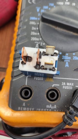

Update

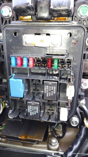

I found the 150A fuse had blown on the outboard.
Also one of the relays looks suspect.
I'm considering getting a local honda guy down to fault find for me.
I don't know how good the diagnostic software is but it maybe worth a punt.
It could cost less than replacing anything I think that's broken!
