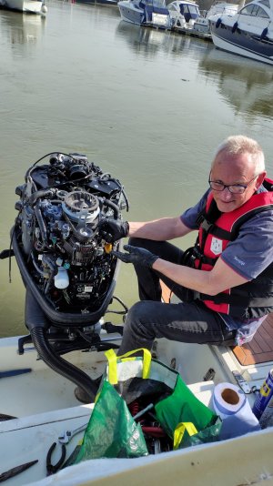

I've removed the fuse panel at the front of the engine and cleaned all the contacts and connectors. One plug had signs of seawater corrosion so that's all removed now.
The engine now doesn't cut out when either trim button is pressed.
So, just the lack of any charging output from the alternator remains as a fault
I've ordered a new equivalent at £198 to be delivered this week which gives me time to study the workshop manual on how to replace it.
I also have a local Honda agent booked for a couple of weeks time. If I've sorted the charging issue then I'll get a diagnostic report along with engine hours which will no doubt give some comfort to the prospective purchaser.

Update
Alternator received, I'll fit it tomorrow and give it a go.
If that doesn't fix it then I'm not going to replace endless parts as a method of fault finding.
Maybe the diagnostic report will flag up the specific problem...

Update.
Guy from the local Honda dealer is coming tomorrow to plug his laptop into the dunked engine.
I've run it up a few times and everything seems ok.
When I use the trim up/down button the low voltage alarm on the throttle goes off.
I know the hydraulic pump pulls a big current as every outboard I've had I see the voltage drop significantly when it's operated.
I'm getting over 14 volts at the battery following the alternator replacement.
