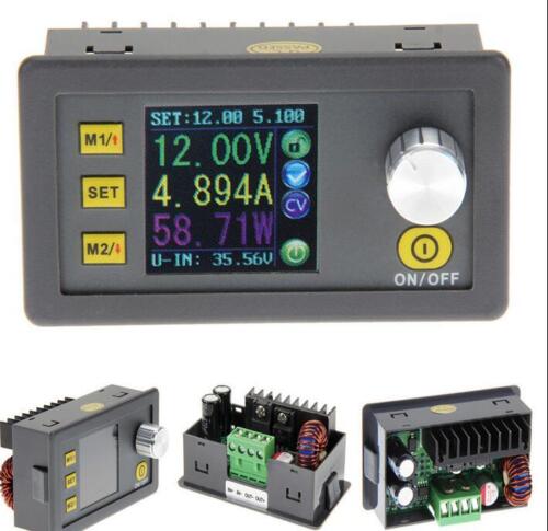

My question now is what could i usefully do with the Makita battery holder?
You could add something like this >
And have yourself quite a sophisticated roving power supply, I've similar & use it a lot, useful setting a current limit low so you can test stuff without blowing it up
