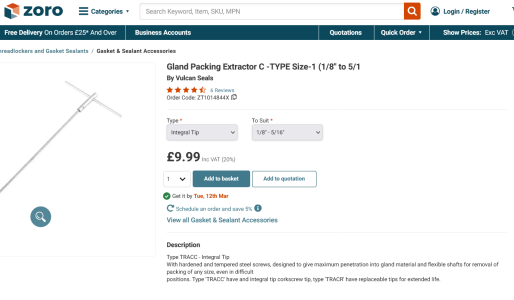

A dentist like pick is ideal for hooking out the old packing.
