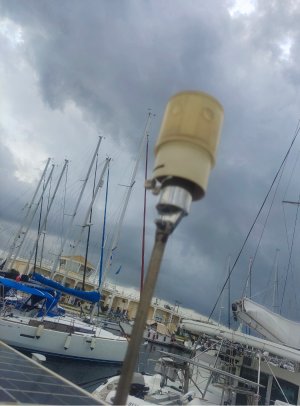

My totally autonomous anchor light was bought in about 2009. I put it up in April and take it down in October. It switches itself on at night, off in the morning and charges itself using a built in small solar panel in daytime. I bought a spare a few years later in case it failed but it remains unused. Perhaps the best yachting kit I have ever bought. Looking its age now but still working well.Screenshot_20241005_120251.jpg

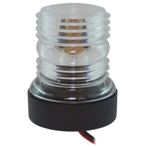

If you are going for something temporary, why not get an anchor light, wire it up to a lead, plug into your ciggy lighter outlet and hoist it?
Then when you have time, wire it permanently.
