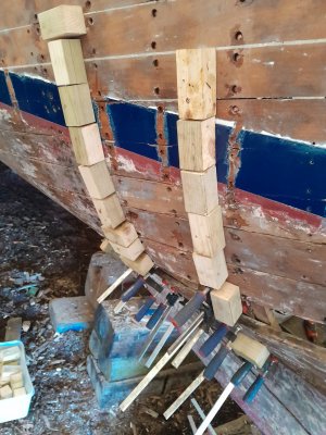

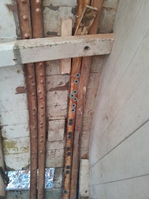

As an update, having inserted two doubled gunnel to gunnel iroko laminated replacements plus some shorter one's as well for the heads area, after Christmas we moved into the fore-cabin, certain it would be easier further aft in the boat we went. It proved not to be so. The first pair aft of the heads/fore-cabin bulkhead buckled upwards at their rear edge at the sharp turn of the bilge. After a few days agonising, I had them removed, copper nails, roves and all. We then experimented and found the solution was steamed iroko laminations, but because wet from steaming had to changed to polyurethane glue. This seems to have worked remarkably well, such that we are considering continuing on like this rather than dry laminations with epoxy + gap bonding filler.
