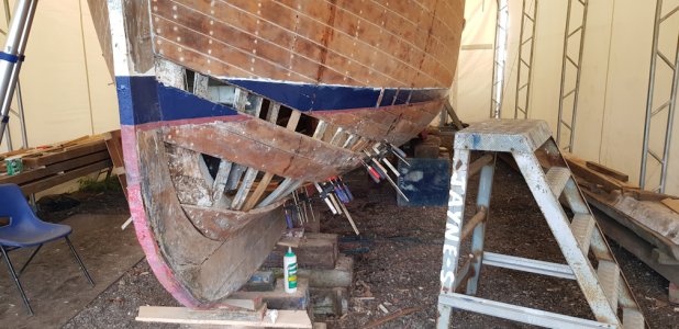

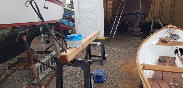

I'm doing a major rebuild of my estuary cruiser, Straight Across. She is a 30' version of the ARC Marine Everyman design, built in Littlehampton in 1951. We have owned her 40 years in December, my grandfather also owned her 1956 - 1974. This is the third time in our ownership we have taken her apart, although the two previous times were on the Thames at Hurley, with the work done by Peter Freebody. She is now in NE Essex at Titchmarsh Marina, Walton on the Naze. As an aside she is about 100 yards away from where Simon is rebuilding Chance/Token. We only restarted in earnest a couple of weeks ago and are having an interesting time. My intention, having done this before and not wanting to end up with rotten oak in a few years, is to replace the steamed oak timbers with laminated iroko - using iroko I had left over from the 2002/3 rebuild. Whilst this might sound simple, what we found was the timbers ot only curved downwards, but also forwards. The 1/4" iroko bent following the shape of the hull, but cracked when we attempted to twist forwards. We then steam bent some oak in, with the intention of reverting to laminated iroko further back. Today we had a go at steaming the laminations, made much easier to get in but also noticed a third complication - the laminations really should be tapered to match the hull such that there is a gap at the aft end of the laminations. Hoping to learn & get right the more we do. To steam we're using a timber long box and a wallpaper steamer - appears to work. The laminations mainly aren't in the correct place, today trying to get some pre bend in them.

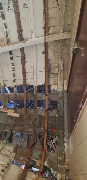

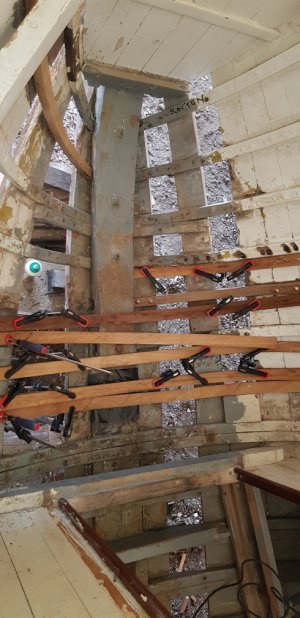

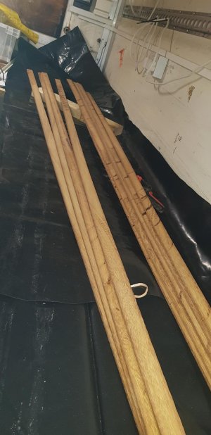

Not progressed with the steam in a bag idea. At the beginning of the week steamed a solid 1.5 x 1" and about 5' long piece of iroko in - did it but was an effort. Last week I had built a 14' long steam box specifically to steam iroko laminates. However on Wednesday cut 13' long, 1.5" wide, and 3/16" iroko laminates to steam, but they were so floppy had a go at putting them in unsteamed - it worked a treat, and as they were so floppy the height of the tent over (about 5') wasn't a problem either. From where we wanted to put them in, the 2nd stringer down, they bent in a big arc back onto the boat. Then we had another eureka moment, getting the 1" thick laminates between the stringer and the hull was difficult, but a couple of wedges banged in underneath resolved that. On Friday we glued them up in the container and transferred and put onto boat - more wedges and effort, and they were in. We then either clamped to remaining planks where planks removed, or used the hex screw with a block as used on the YouTube video noted above to squeeze the laminated together/onto the hull. we need to perfect how to get the laminates in line - they move laterally against each other. But then started nailing/roving. The big impression I had was after how time consuming the nailing process was - I employ a skilled shipwright to help me three 4 hour mornings a week - I'm going to need extra & longer help to get nailing done. The new frame is the one on the right below.

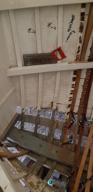

ianc1200
6 Dec 2005
3,314
Frinton on Sea

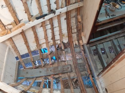

Progress - some full length steamed oak, some scarfed (because of restrictions of height over due to tent) & three to right in photo laminated iroko. Holding laminations against hull has proved a problem - we can't copper nail until set as top laminations split when nail is hammered through. We are going to use dry wall screws & blocks on outside for the next frame.
