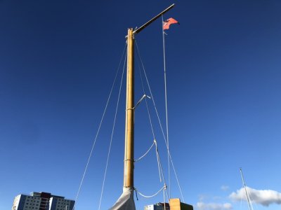

Thank you -my suspicion it was 3-4k but I have no intention of replacing in short term -clearly if we were setting sail for the Med or suchlike different viewpoint . Likewise we don’t want to end up looking like the wooden mast below though which I guess will be a pricier repair.
