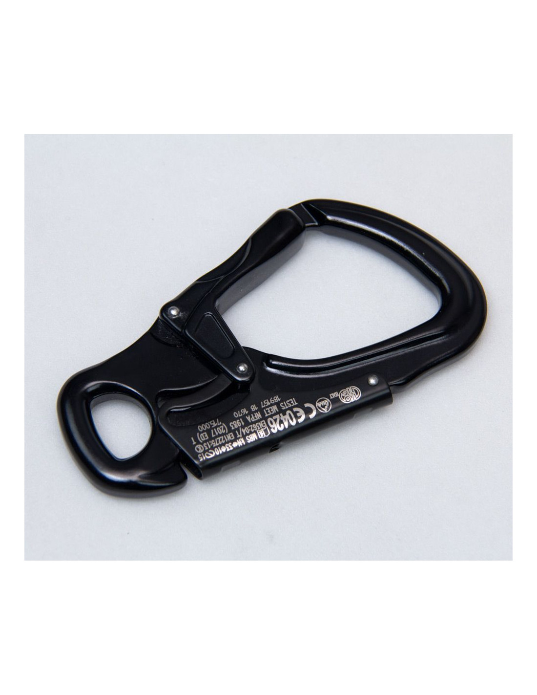

What was missing from the yachting standard is a requirement for side load and open gate testing. These are how carabiners actually fail in the real world, and that is what the Spinlock Race clips missed.
A bit of history. The Gibbs Safety Snap, upon which the Spinlock Race Clip was based, is MUCH thicker and can take a reasonable side load. But the standard did not require that test and Spinlock (and others) took this opertunity to save weight and reduce manufacturing costs by stamping them out of thin metal, ruining the design (which honestly, is obsolete anyway).
Notice the increase "meat" in the Kong clips they now use. Designed for via ferrata climbing, they meet the side load and open gate requirements. Also easier to operate with winter gloves. Because they are used by climbers and the militaries, they are FAR most use-tested and proven than recreational marine designs. They will clip a 1-inch railing, yet weigh no more (both are about 130g). The original Gibb was heavier.

The side load test required by ANSI, OHSA, and UIAA 121 Type K (the kong Tango) requires that a connector be clipped to the pin and loaded downwards with 8 kN. This simulates mis-loading that happens in real world falls in industry, via ferrata climbing, and sailing. The Kong connector can pass this easily, as can many other Type K connectors and all industrial connectors (required). Most carabiners cannot (I have run this test--it requires considerable beef in the athwartships direction).
Whether World Sailing will adopt this standard is unknown. In the first round they said it was impractical, since a new standard would need to be developed ... which was rather silly since both the standard and equipment already existed. Jingoism IMO.
Corrosion is a minor problem if the gear is properly maintained. You will see these on Volvo boats and they been on cruising boats for 15 years. If you keep them in a bucket of seawater, yes, eventually there could be a problem. But they do well if lubed once a year. I've been using them for a decade. Nothing new here. More like a well proven evolution.
