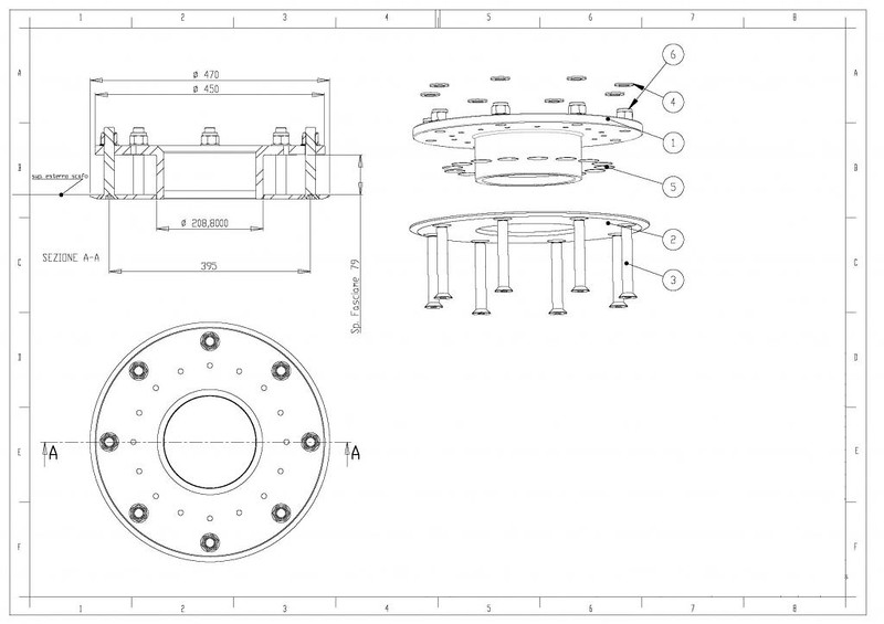

Bart, how did they cut that plug out of the hull? There is no centre hole (for a machine cutter) and the edge seems to have teeth marks all the way around. Did they just chain drill it (blimey!)?
I wondered the same. Finally decided that they may have bolted the non-stepped flanges so they were sandwiching the hull and then used a magdrill to ensure the axis of the bore was at 90deg to the flange.
indeed this job was done in a very "amateur" way,
they told me they used a jigsaw (broke many blades), I was'n't there at that moment,
they must have been using a drill aswell, looking at the traces on the plug,
but fortunately the shape and finish of the edges of the opening in the hull were very good, and nicely 90°
I assume one has been using a grinder and a file tool and "lots" of elbow grease,
that was confirmed to me by one of the workers
I realised that this could have been going terribely wrong.
but again, luckyly we had absolutely no issues with the shape nor size of the opening
for drilling the 8 x 20mm mounting holes, done by a friend and myself,
we made a tool, from a few plywood dished, (perfect pattern of the system flange) and a drill stand on top,
so that the positioning was perfectly accurate.
all fitted nicely without extra grinding, and a vertical gap in between the hull and flange of 1..3mm wide
I'm not sure how they have acheeved that perfect 90°
the only thing they got from me was a drawing, and this part (flange) from the system,
