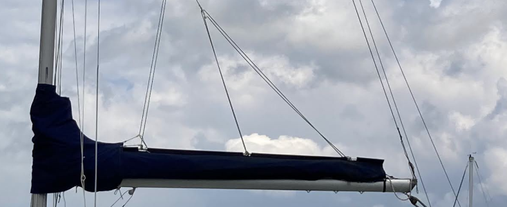

The poles run horizontally, with the ropes tied down onto it. They are mostly covered by the cover as they run through sleeves in it, but are exposed at the points where the ropes attach.
Thanks for all the feedback so far!
