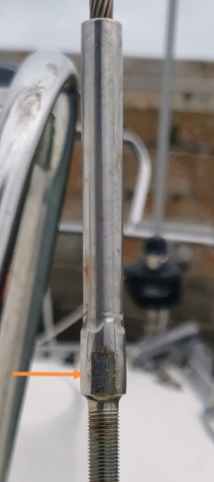

If 10mm is too small and 11mm is too big, it's proably whitworth or BA. In which case, my advice is a good quality small adjustable, something like a Bahco. Cheap spanners or ones that have been ground will have poor strength, and at that size a good adjustable will be better. I am a time-served marine engineer, I have sworn on the bible that adjustable spanners are the work of the devil, and I am fully invested in my special tool colelction - but even I stop short of sourcing a BA or whitworth spanner! My little (6") stanley one has come in handy a few times - yours for less than a tenner from Mr. Bezos online big box store...
Just seems. Odd that they don't make the end. Fittings a metric size. Boat is German from 2001.

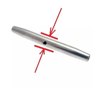

Sometimes one finds these closed body turnbuckles that have been compressed and deformed in the area between the arrows (sorry could not find a picture of an actual one) to give them an area of two parallel flat surfaces instead of circular; the deformations appear rustic and home made, often of unknown and variable sizes an adjustable tool is quicker.
Why would they do that, given there is the central hole to help screw/unscrew them?

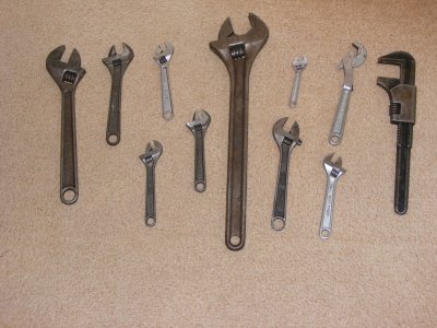

You can't have too many adjustable spanners.
The left handed ones are useful sometimes ;)
