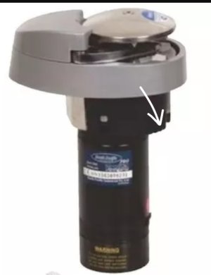

Has anyone fitted a chain counter to a South Pacific Vertical Windlass?

So update on this one...
This does not apper to be documented anywhere on the Internet, so I thought I'd post it to help someone in the future.
There is a little hole in the heat sink that just fits the transducer (sensor) for a chain counter. Just slide it in and push it home.
Then just expoxy putty the little magnet to the underside of the gypsy and off you go...
Mine worked first time.
