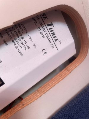

Anyway, I got on with my other jobs and after an hour or so, noticed a humming noise in the saloon and after a bit of poking around traced it to the cooling fans of a Newmar Phase Three smart battery charger. It was very hot, to the point of making the surface temperature of the cabinets above and around it etc hot. The surface temp of the Phase Three was similar to that you'd get from a domestic radiator with the heating on full blast. The ammeter on the front was indicating that it was pulling 32Amps. I have never noticed the fans running or it getting hot before. Really, it just didn't feel right.
It's a horrible installation - nasty piece of wood butchery and the device sits behind the saloon seating, blocked by the cushions. To be far to whoever installed it, i can't see an obvious alternative location. When I left, I took the boat off SP, didn't feel comfortable leaving it on.
On Sunday I went back down, plugged it in again, but this time I removed the cushions and it didn't seem to get quite so hot, but was still pretty warm. The ammeter dropped back a little and was showing about 28Amps.
On reading up on the device later, I concluded that the 32A draw was correct as it was in full charge mode, and that what I saw on Sunday was the start of it backing off and beginning to drop charge down to trickle mode.
It was hot over the weekend, well over 30 degrees, so that would have contributed to it getting hot along with the high charging draw and rubbish location with poor air flow.
So, my conclusion is that the electrics are sound and the device is doing what it should do, but that maybe the cooling fans need replacement, air flow seemed poor even with the cushions removed. That I should see much lower amperage when the batteries are fully charged and that it shouldn't get hot in normal use, although I will remove the cushions when using SP, particularly if its hot weather and figure out a way of improving air flow over the unit. And that I should replace the PV panel.
Does this seem a reasonable conclusion? And yes, I am trying to track down a local marine sparks to talk tocharger.jpgpv.jpg

Does this seem a reasonable conclusion? And yes, I am trying to track down a local marine sparks to talk toView attachment 158950View attachment 158945

Your charger in what looks to be an unventilated area will get hot, especially if it's pushing out 32amps.

I can probably improve the vent to the charger whilst looking for an alternative location and may just have to live with propping the cushion away from it when on SP. I suspect if batteries are charged it will sit there quietly delivering normal domestic current/battery trickle charge without overheating as it seems to have done for years since the previous owner installed it.

I strongly suggest that you relocate the charger. No ifs or buts. I would consider it a fire risk in the present location. Completely agree with pmagowan.
