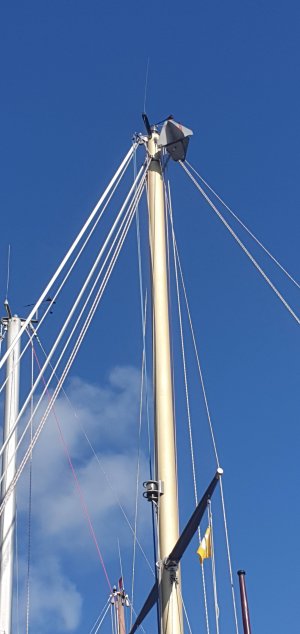

On the subject at hand: below the only photo i have of the mast top. Indeed about a 25/30 cm offset between the two stays. One thing to take into account is that we did need to add extra tension to the back stays to get both forestays to enough tension so that the heavy rolled-up sails do not start bouncing (not sure if that is the right word for this). I also added a picture I got from the son of the first owner of the boat on the warf when it was build. He happens to live the 5km from where we are moored and he spotted the boat from the big radar reflector in mast.

Thanks for the photo of the mast head. It will be useful to show my rigger what is required. I work closely with Kemp Sails who have made all the sails and canvas work for my boats for the last 35 years or so. The mainsail works very well, although if we did it again it would probably be fully battened because I have now fitted a Tides Marine track to the mast which is so much better for raising and dropping the sail. Before we were not confident that batten cars would work in the original Proctor track plus the battens would be very long and put a lot of pressure on the batten cars. However the Tides cars would work well, we think - but not going to change because the sail works OK.

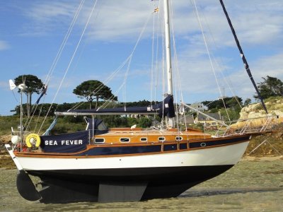

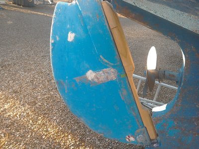

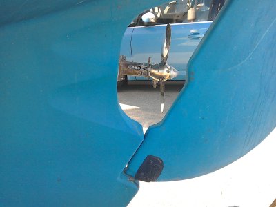

When Mark Urry took over the moulds in 1996 he did a lot of detail redesign, primarily to meet the RCD requirements for Category A. The biggest change was a slightly deeper draft and more ballast which in turn made a bigger rig with a taller mast possible. The new mast was 39', which Terry had used on some boats, and finally a 41' cutter rig which went on the last boat, Sea Fever which is in the first photo. This also shows the rudder that Mark designed to give about 15% blade area forward of the pivot. This is what I based my modifications on, although as you will see from the photos my cutout is different for 2 reasons. First the engine in Mark's boat is set at 10 degrees down and mine is 7 ; his prop is fixed blade and mine is feathering so the cutout had to be big enough for the blades to clear when pivoting. The construction is very simple. I cut the extension out of a piece of Douglas Fir left over from making a spinnaker pole. The original rudder was epoxy coated so the new bit was epoxied on sheathed and blended in.
Difficult to say what difference it has made because I never sailed the boat with its original rudder, but others who have done similar things report a reduction in weight on the helm and a tighter turning circle. By today's standards the rudder would be considered inefficient and no doubt a new blade shape with a greater area lower down and better profile would be a big improvement. This is the sort of thing a did with my Eventide which had an even worse rudder initially, but not sure I want to go to all that trouble again as so far I have no complaints about helm weight and turning circle is less of an issue when there is a bow thruster.
