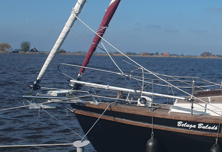

That is exactly what I plan for my Golden Hind which currently has a large overlapping genoa to the stemhead but an extra forestay about 2' further forward on a bowsprit. Discussed already with sailmaker about a higher cut smaller sail to the stemhead and move the big genoa on a new furler to the outer stay. No final decision as have yet to sail the boat, but pretty sure will go this way.
We did just that with our Golden Hind. The previous owner put on a large genoa (140%) which was a beast to tack. We put on a (small) bowsprit, moved the genoa there and have a smalle gib just on the bow which we used in short tacking and heavier winds. It works great for us. We can also have both out depending on the course and wind.

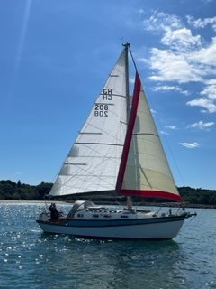

This is what we have. 135% genoa on the main furler ( 700sqft) and 285sqft working jib on inner furler. The 295sqft is probably about 80% and only twice the size of our storm jib.
The inner furler is set 2ft back from the main forestay and is parallel to the main forestay. This was a deliberate decision. It means the connection point of the inner furler is 2m down from top of the mast. We installed checkstays at the same time. For upwind work, we don't ever reef the genoa. We simply roll it away and roll out the blade jib at circa 20kts over the deck. The performance up wind in 22 kts and above, over the deck, is way better than a reefed genoa. We point higher, pitch less and the boat is way more comfortable. As the wind rises and we reef the main, the check stays can both be left on once we have two reefs in the main.
In light winds, we can still tack to windward under genoa. Sometimes I need to go forward to assist the genoa through the gap between furlers as there isn't enough wind to drag it through. If we are tacking in a crowded anchorage we just use the jib as it tacks fast and is super easy to sheet in on the next tack. We don't want a large genoa in this situation anyway.

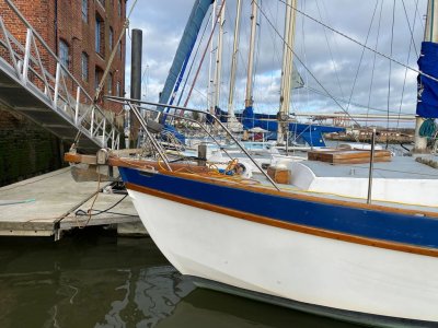

My boat (number 208) had a short bowsprit from new, much the same length as yours. The first 2 photos shows the layout - not my boat but identical in that respect. The next photo shows my boat as it is now, and the last under sail last week with the jib set in the way I have found best. I already have a new mainsail which is larger and with more roach than the one that came with the boat and a Tides Marine sail track which makes raising and particularly lowering so much easier.

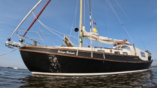

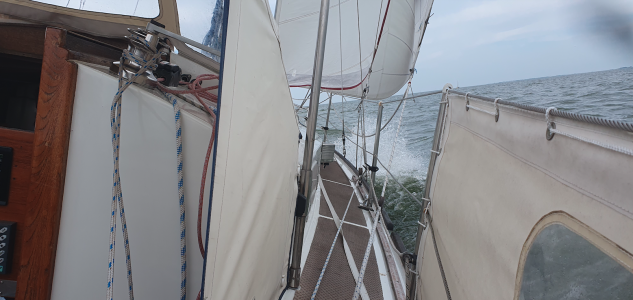

Very cool to see! Our boat (nr 211) seems very similar. As far as i can see you have the same 'ocean rig' with the rather short mast as we have. A new main is on the list with as much area as we can get.
I've attach a detail of the bow layout and two photos of the foresails in action. We generally only have on out when heading to windward but there is a narrow range (footing) when getting out both gives us half a knot extra.
We got ours three years ago (after having sailed a Dutch barge for 7 years) and love it. It is a bit of a project because it had been standing in storage (heated hall) for +10 years but apart from some small leaks at the cabine entry bulkhead it has been amazingly well preserved.
