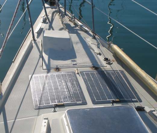

I have 2 Solara 120M and I 'm very pleased. I didn't have to add any superstracture to the boat and I do have some considerable charge (25Ah per day in the summer). In fact a rough estimation shows that their Amp/m² performance is not significantly lower than that of the rigid ones.
Kyocera (rigid, one of the best) KC40: 65.28cm * 52.58 cm = 0.343 m² , 2.34 Amp , 6,82 Amp/m²
Solara (semi-flexible) SM120M: 58.93cm * 44.96cm = 0.265 m² , 1.7 Amp, 6.49 Amp/m²
Please check my calculations as they seem too good to be true to me...
Partial shadowing does not seem to shut them off altough some performance loss is inevitable.
OTOH this is Greece ...
I have posted a picture recently but I will repeat here for convenience:
Barry
