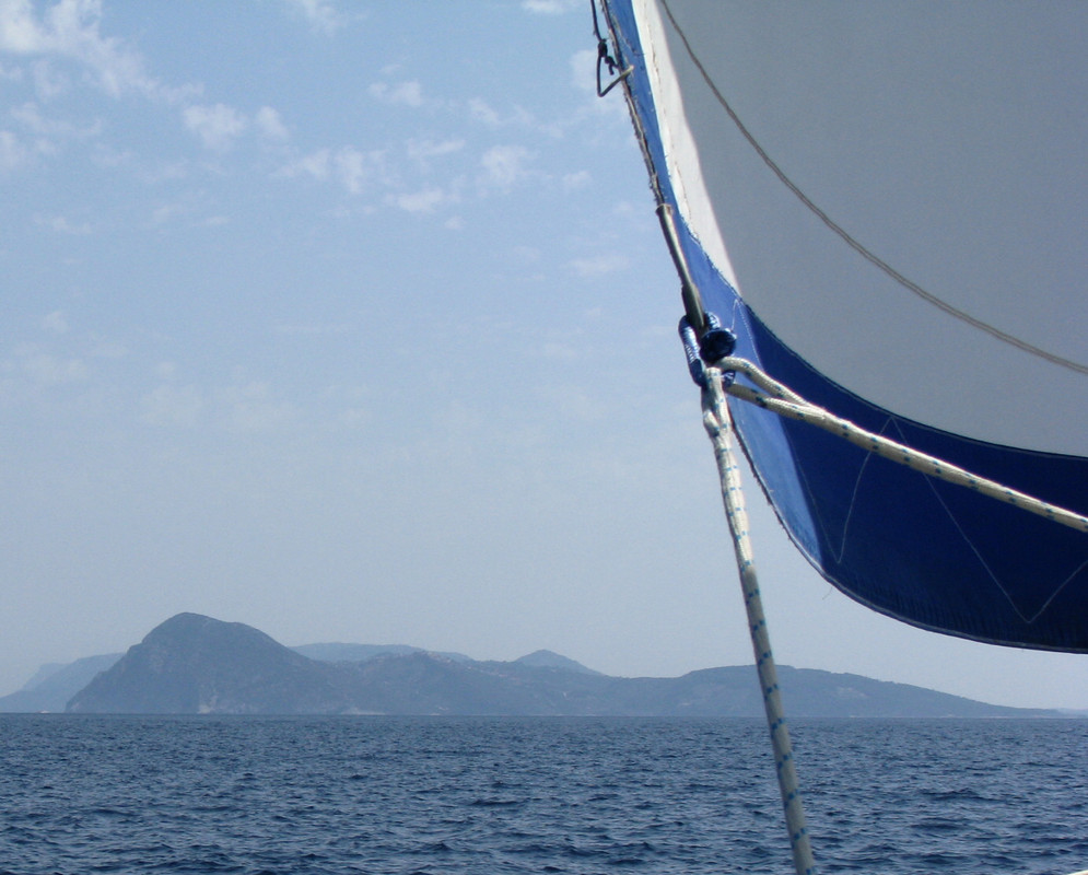

Lost of talk of Jib sheet attachment and the use of bowlines. I prefer to have a single line for the Jib sheets, attached at the clew with a cow hitch. No bulky bowlines to snag and if you have the line a little longer than normal you can move the hitch alone a little each season, thus moving any wear points, making the line last even longer.
This photograph of a soft shackle connecting my genoa sheets to the sail was taken in 2009. I still use the same shackle, faded from its original blue to almost white, but apparently as strong as ever. Our boat has a fairly large overlapping genoa that takes a lot of winching in on a beat but the shackle has never released itself nor, obviously, broken.
