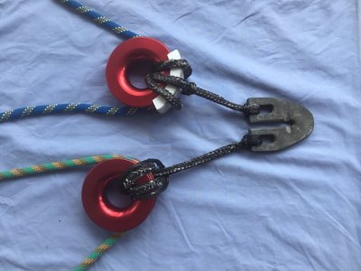

I have 2 of the large LFRs and have been trying to find a use, other than 4x4 recovery, for them
The white device fits the LFR and helps retain the cordage to the LFR. The white device is simply a use for 3D printing. The bridle plate is an early iteration. The two ropes are 12mm, for scale, dynamic climbing rope (from China). The black cordage is simply spliced Liros dyneema, black, not red nor blue and cow hitched to the LFRs and the plate.
As far as I can ascertain LFRs are made for sailing (and some form of hang glider - maybe motorised) and coming sizes upto about 12mm rope. These recovery LFRs are huge, there is a large size gap between 'ours' and 'theirs'
New ideas would be welcome

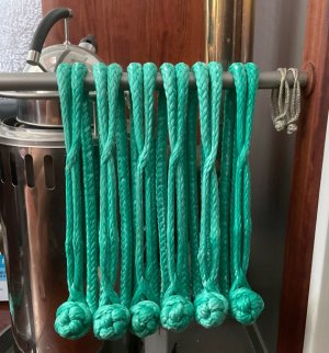

My wife recently made some soft shackles from 12mm Dyneema. This was the core from a halyard that was replaced by a fellow cruiser due to a damaged cover.
This Dyneema does not have any UV or abrasion coatings, but they are stronger than we need for any applications and they did not cost anything. The line would have just been thrown away if we had not made use of it.
The photo shows the 12mm shackles next to some constructed from 3mm HMWPE line. We have the extremes covered :)
