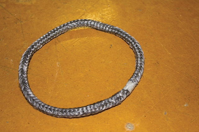

I'd recommend a 2-part solution:
First, a Continuous Loop in 6 or 8mm Dyneema. Length to suit convenience.
This is fastened around the chain using a Prusik Knot and pulled tight. Cost under £5. Easy to DIY. This is likely to fray and chafe, so have a spare or two.

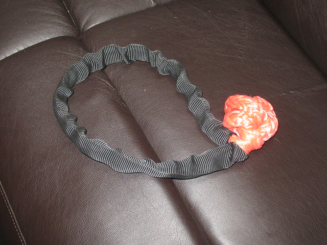

Second, a robust Soft Shackle.
This is looped through the s/s eye in the snubber and also through the Prusik Loop.
Available from AliExpress at circa £5, or chandlers, or DIY like me.
